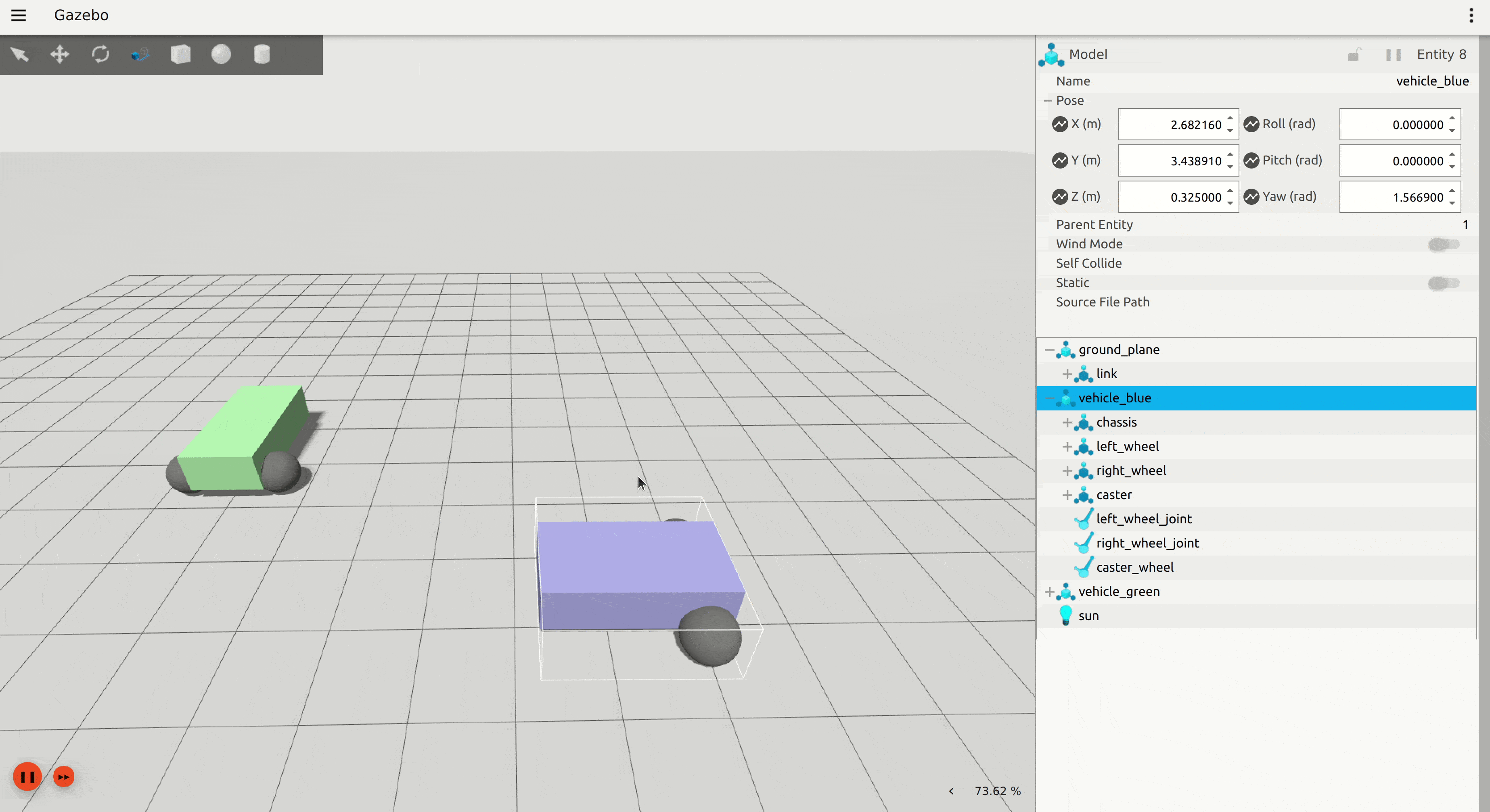

Monitor the model and link pose
We can monitor the model pose by selecting the moving car and then select the drop-down list Pose. Moreover, we could also read the model links' poses relative to their parent link by selecting the corresponding link on the model tree:
Note that using the model tree as shown in the above gif, we can view the parameters and properties such as visual or collision of each link or joint in the model. For more detail about the kinematics of the model tree, see this tutorial.

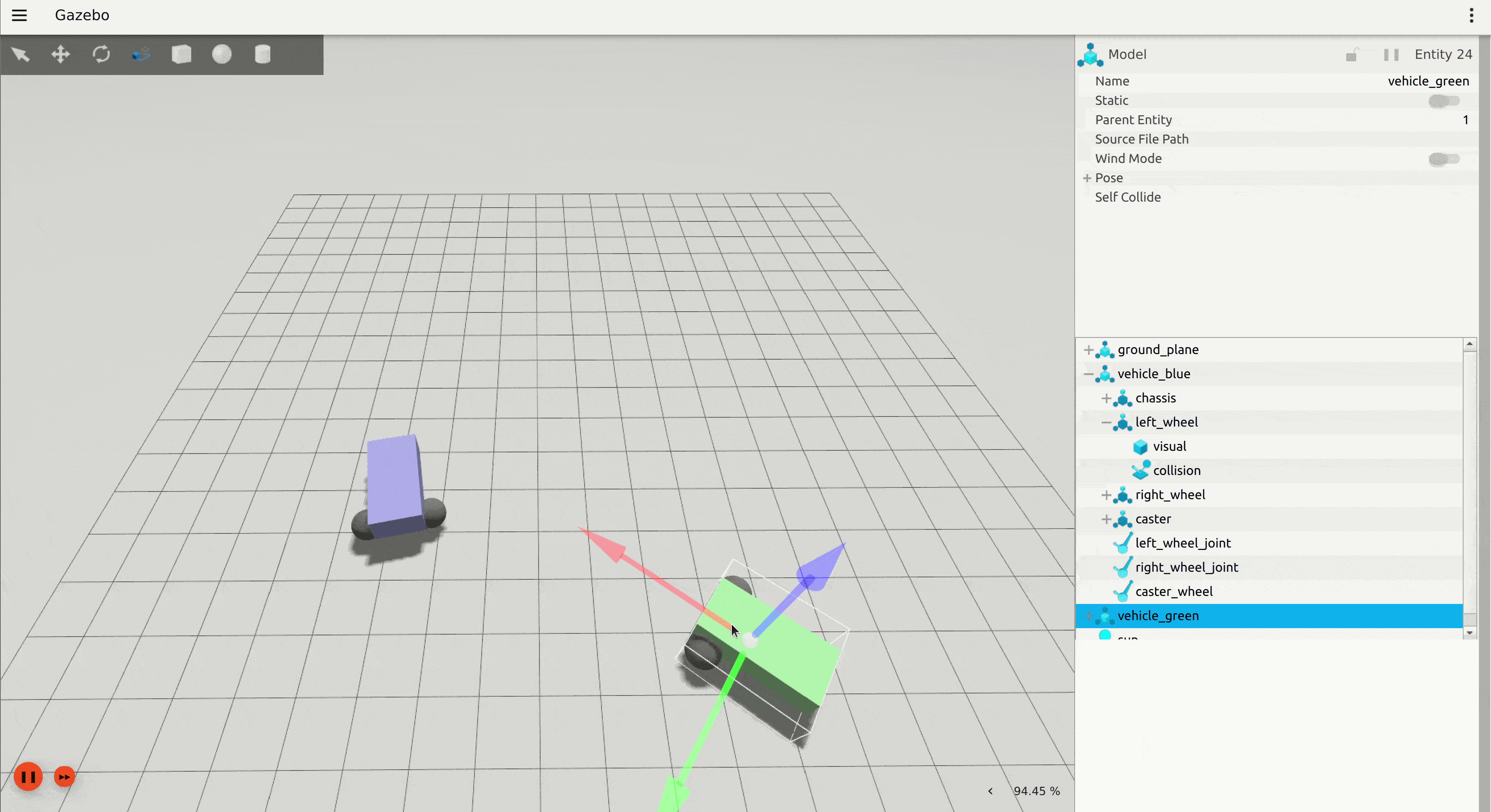

Collision effect
Ignition Gazebo also simulates realistic collision effect. While the vehicle_blue car is moving in a circle, we can move the vehicle_green to be on vehicle_blue's upcoming path. The blue car will then push the green car in the following demo.
To see where these collision parameters are set in SDFormat and how it works, please see this SDFormat tutorial.

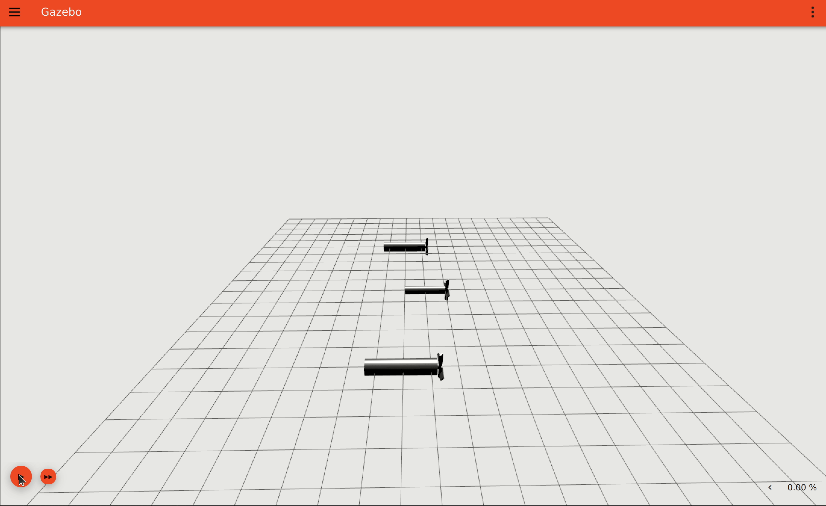

Buoyancy
This demo world shows how buoyancy is supported in Ignition Physics. This world contains the following three models:
  1. submarine: A simple submarine model that floats in place.
  2. submarine_sinking: A simple submarine model that is not buoyant and sinks.
  3. submarine_buoyant: A simple submarine model that is buoyant and floats.
To run the demo, download the Buoyancy demo to your home folder by:
wget https://raw.githubusercontent.com/ignitionrobotics/ign-gazebo/main/examples/worlds/buoyancy.sdf -P ~
Run demo on Ignition Gazebo by:
ign gazebo buoyancy.sdf
After pressing the Play button, demo will run as below:
The buoyancy concept is implemented by simulating fluid density and applying the force on the object in the fluid proportional to its volume. Hence, you can change the model buoyancy by modifying its inertia, see SDFormat link specification on how to do that.

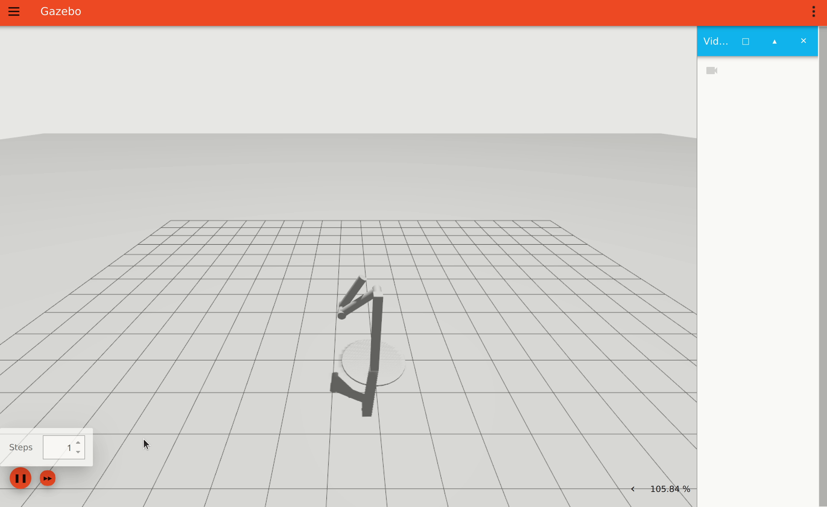

Pendulum
This demo world demonstrates how simulated inertia and gravity affect the object movement by showing free swing of the pendulum. Download the Pendulum demo to your home folder by:
wget https://raw.githubusercontent.com/ignitionrobotics/ign-gazebo/main/examples/worlds/video_record_dbl_pendulum.sdf -P ~
and start the Pendulum demo on Ignition Gazebo by:
ign gazebo video_record_dbl_pendulum.sdf
After pressing the Play button, you will see that the pendulum will oscillate around its main revolute joint forever due to lack of friction (it is undeclared in the SDFormat file).
The oscillation period or the max angular speed of the joint will change if we modify the inertia of the rods. According to the demo below, you will see that gravity is defined as -9.8 m/s^2 on the Z-axis. Refer to link specification for modifying the inertia and mass of the links.

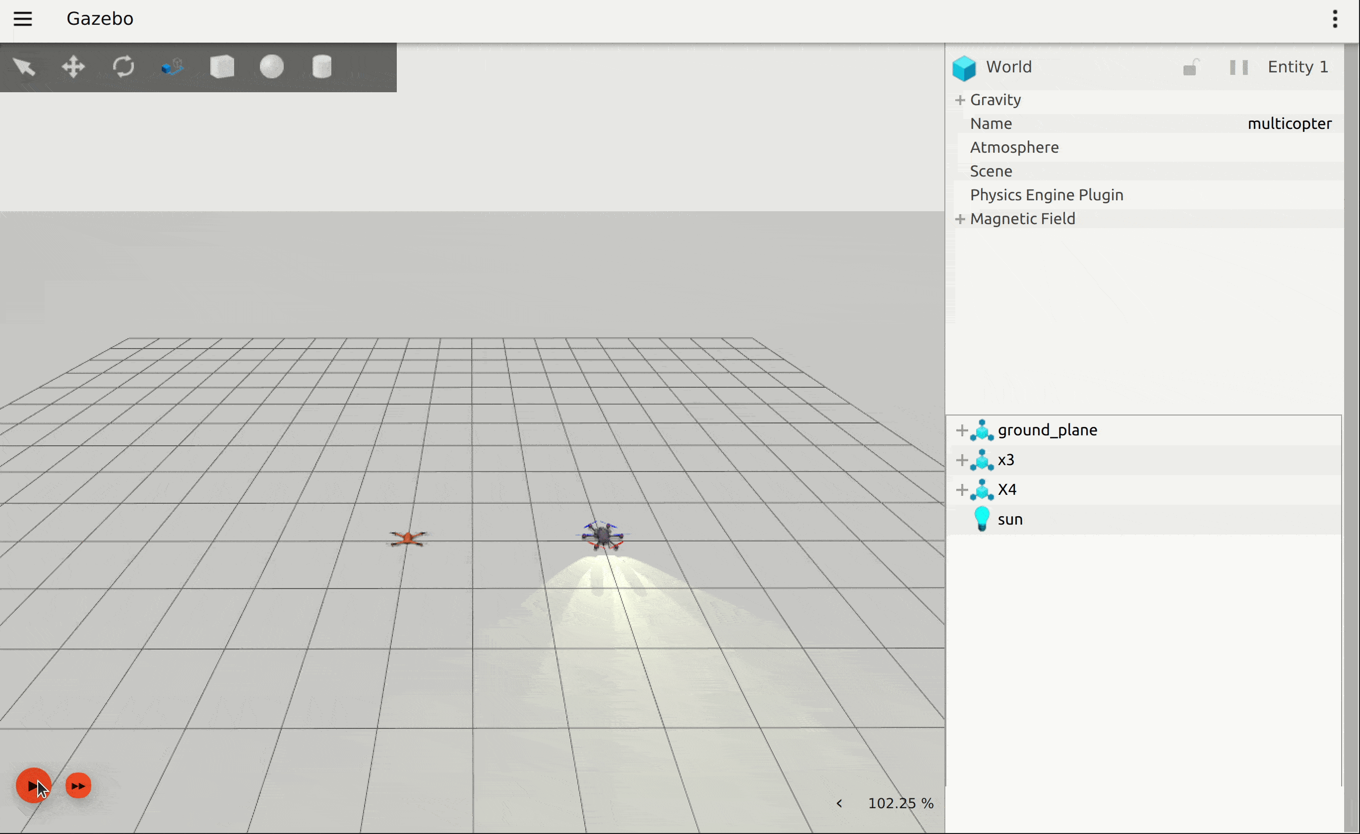

Multicopter
This demo world shows how Ignition Physics supports gravity, actuators and inertia to control object velocity. Download the Multicopter demo to your home folder by:
wget https://raw.githubusercontent.com/ignitionrobotics/ign-gazebo/main/examples/worlds/multicopter_velocity_control.sdf -P ~
and start the Multicopter demo on Ignition Gazebo by:
ign gazebo multicopter_velocity_control.sdf
To control the multicopter to ascend and hover, in a separate terminal window, send a Twist message to command the X3 multicopter ascending 0.1 m.s as follow:
ign topic -t "/X3/gazebo/command/twist" -m ignition.msgs.Twist -p "linear: {x:0 y: 0 z: 0.1} angular {z: 0}"
then hovering:
ign topic -t "/X3/gazebo/command/twist" -m ignition.msgs.Twist -p " "
Do the same for the X4 multicopter. After pressing the Play button, you will see both of the multicopters will ascend, this demonstrates how the physics engine utilizes model kinematics and dynamics to support simulating complex model and its controller. For more details about the multicopter controller, please see MulticopterVelocityControl.cc.
