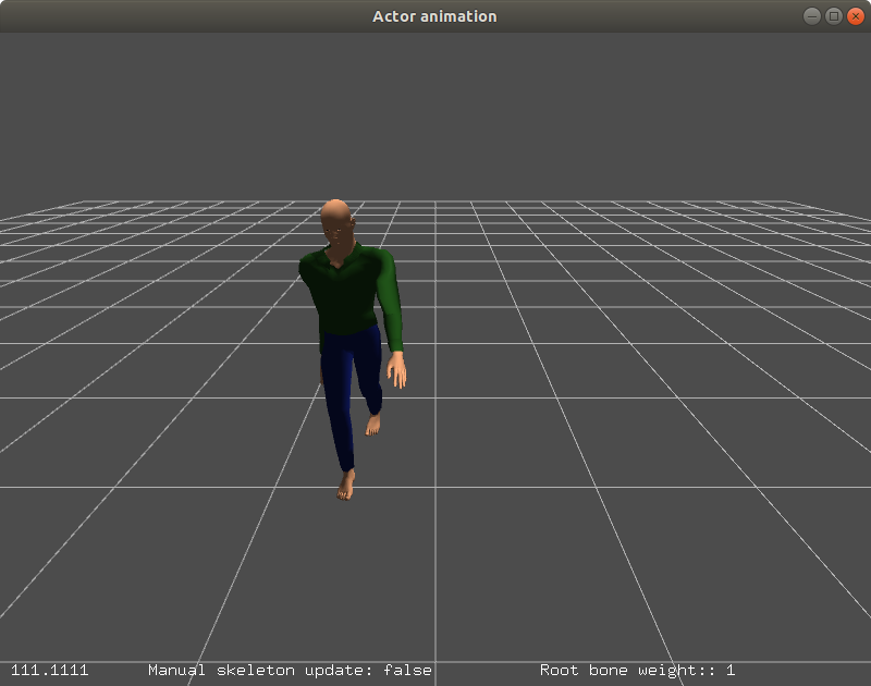

When the code is compiled you can execute the example with the following command. Using the left and right button of the mouse you can move around the scene and zoom in and out.
./actor_animation

There are two ways to play the animations:
  • Update animation time: The first method is to advance the time every iteration and let the render engine handle the animations.
ir::MeshPtr mesh =
std::dynamic_pointer_cast<ir::Mesh>(v->GeometryByIndex(0));
mesh->UpdateSkeletonAnimation(
std::chrono::duration_cast<std::chrono::steady_clock::duration>(
  • Update bone pose: The second and more involved method is to manually compute and set the bone pose over time.
