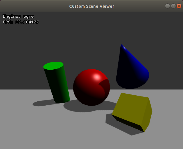

This application allows us to view a number of pre constructed scenes. The initial render engine is Ogre.
When the application starts you will see a blank window. When you click the + or - keys you can change the scene. By pressing the Tab button you will advance to the next render engine.
You may see the render engine title in the window change to Optix if you have compiled your Ignition Rendering library with OptiX (otherwise you can only use Ogre). The frame rate may also change based on your computer's capabilities.
The following scenes have more primitive objects such as cones or cilinders. Again, you can see the scene with different render engines pressing Tab. Some of the scenes available include:

The AllShapesSceneBuilder class inside SceneBuilder.cc will define more objects such us: CYLINDER, CONE or BOX.
void AllShapesSceneBuilder::BuildScene(ScenePtr _scene)
SimpleSceneBuilder::BuildScene(_scene);
VisualPtr root = _scene->RootVisual();
VisualPtr cylinder = _scene->CreateVisual(CYLINDER);
cylinder->AddGeometry(_scene->CreateCylinder());
cylinder->SetLocalPosition(3.3, 1.0, 0.5);
cylinder->SetLocalRotation(0.0, -0.5, 0.0);
cylinder->SetLocalScale(0.5, 0.5, 1.5);
cylinder->SetMaterial("Green");
root->AddChild(cylinder);
VisualPtr cone = _scene->CreateVisual(CONE);
cone->AddGeometry(_scene->CreateCone());
cone->SetLocalPosition(2.6, -0.8, 1.2);
cone->SetLocalRotation(-0.5, -0.75, 0.0);
cone->SetLocalScale(0.8, 0.8, 1.0);
cone->SetMaterial("Blue");
root->AddChild(cone);
VisualPtr box = _scene->CreateVisual(BOX);
box->AddGeometry(_scene->CreateBox());
box->SetLocalPosition(2.2, -0.8, 0.2);
box->SetLocalRotation(IGN_PI / 4, 0.0, IGN_PI / 4);
box->SetLocalScale(0.5, 0.5, 0.5);
box->SetMaterial("Yellow");
root->AddChild(box);
