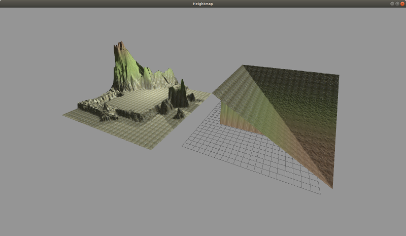

Heightmap
This example shows how to add a heigntmap to the scene.
It loads 2 different heightmaps with different parameters.
cd ign-rendering/examples/heightmap
./heightmap
[Msg] Loading plugin [ignition-rendering6-ogre]
[Msg] Loading heightmap: scene::Heightmap(65528)
[Msg] Heightmap loaded. Process took 217 ms.
A heightmap is a terrain defined by a 2D grid of height values. This demo loads the heights from a grayscale image, where the color black represents the lowest point, and white represents the highest.
