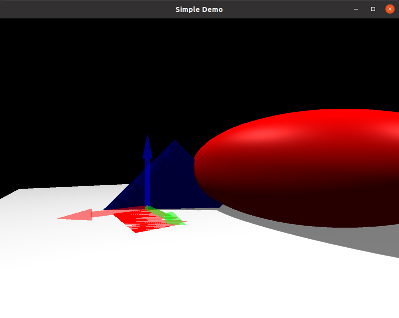

The material API allows changing the render order. When polygons are coplanar, you can get problems with depth fighting (also known as z fighting) where the pixels from the two polys compete for the same screen pixel. As you can see in the following image:

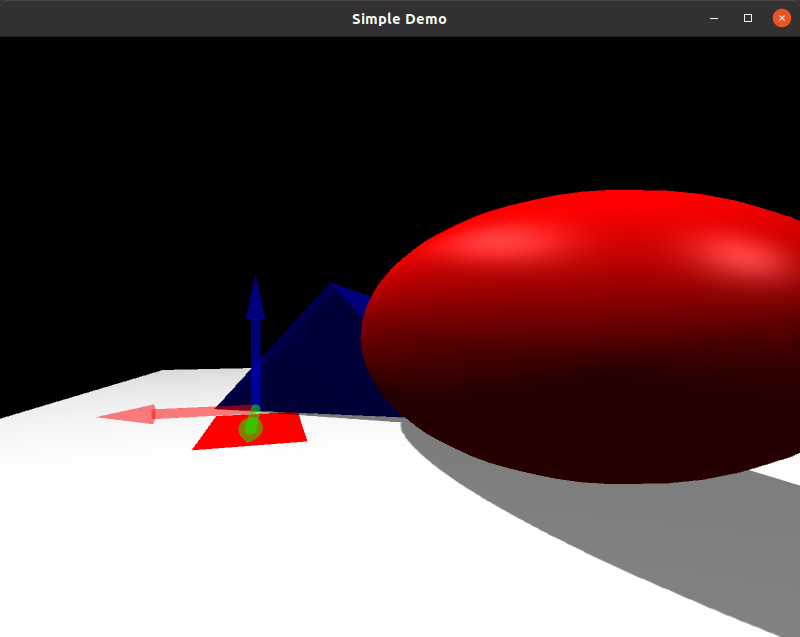

As you can see in the following image the depth fighting issue is resolved.
