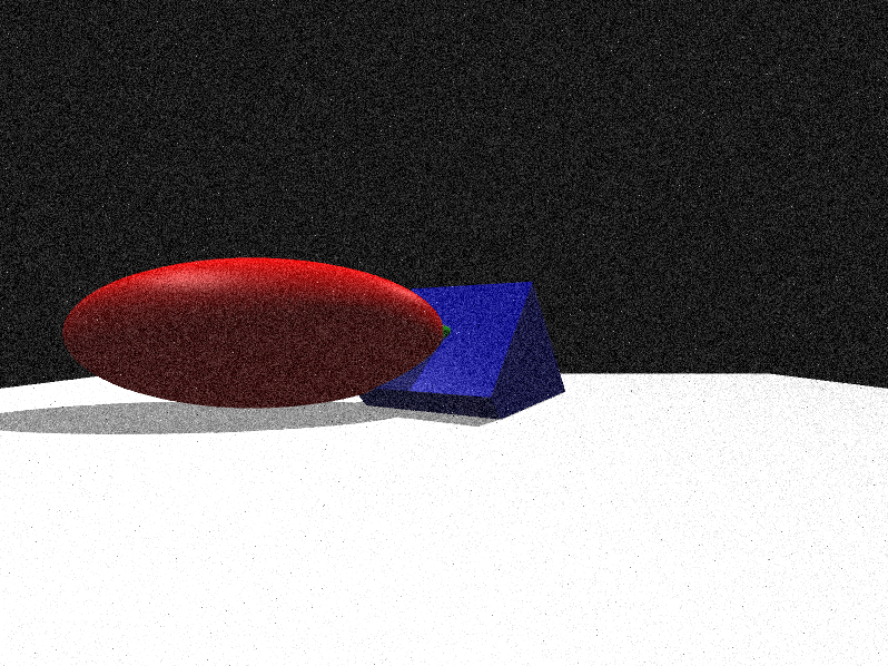

Render pass
This example demonstrates the use of the render pass system for adding Gaussian noise post-processing effect to a camera.
cd ign-rendering/examples/render_pass
./render_pass
[Msg] Loading plugin [ignition-rendering6-ogre]
Engine 'optix' is not supported
Get the render pass system and create a Gaussian noise render pass. Then we just need to set the noise mean and the standard deviation parameters and apply this render pass to the camera.
CameraPtr camera = std::dynamic_pointer_cast<Camera>(sensor);
if (rpSystem)
// add gaussian noise pass
RenderPassPtr pass = rpSystem->Create<GaussianNoisePass>();
if (pass)
GaussianNoisePassPtr noisePass =
std::dynamic_pointer_cast<GaussianNoisePass>(pass);
noisePass->SetMean(0.1);
noisePass->SetStdDev(0.08);
camera->AddRenderPass(noisePass);
// add distortion pass
pass = rpSystem->Create<DistortionPass>();
if (pass)
DistortionPassPtr distortionPass =
std::dynamic_pointer_cast<DistortionPass>(pass);
distortionPass->SetK1(0.5);
camera->AddRenderPass(distortionPass);
