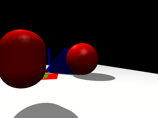

Simple demo
This example shows how move the camera automatically.
cd ign-rendering/examples/simple_demo
./simple_demo
[Msg] Loading plugin [ignition-rendering6-ogre]
Engine 'optix' is not supported
The function updateCameras() is called each time the DisplayCB function runs. Using the method SetLocalPosition from the Camera class we can move the camera in the world:
void updateCameras()
double angle = g_offset / 2 * M_PI;
double x = sin(angle) * 3.0 + 3.0;
double y = cos(angle) * 3.0;
for (ir::CameraPtr camera : g_cameras)
camera->SetLocalPosition(x, y, 0.0);
g_offset += 0.0005;
