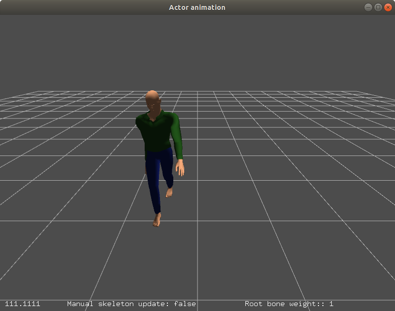

This tutorial will show you how to use the Ignition Rendering library to create an actor animation.
Clone the source code, Create a build directory and use cmake
and make
to compile the code:
When the code is compiled you can execute the example with the following command. Using the left and right button of the mouse you can move around the scene and zoom in and out.
