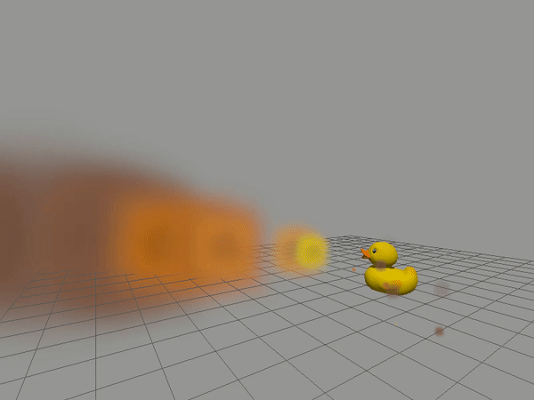

Here's the snippet of code from examples/particles_demo/Main.cc
that includes a particle emitter to render particles to look like smoke:
ParticleEmitterPtr emitter = _scene->CreateParticleEmitter();
emitter->SetType(EM_POINT);
emitter->SetLocalPose({2, 1.10, 1.25, 1.5708, 0, 2.3});
emitter->SetRate(10);
emitter->SetParticleSize({1, 1, 1});
emitter->SetLifetime(2);
emitter->SetVelocityRange(10, 20);
emitter->SetMaterial(particleMaterial);
emitter->SetColorRangeImage(RESOURCE_PATH + "/smokecolors.png");
emitter->SetScaleRate(10);
emitter->SetEmitting(true);
root->AddChild(emitter);
