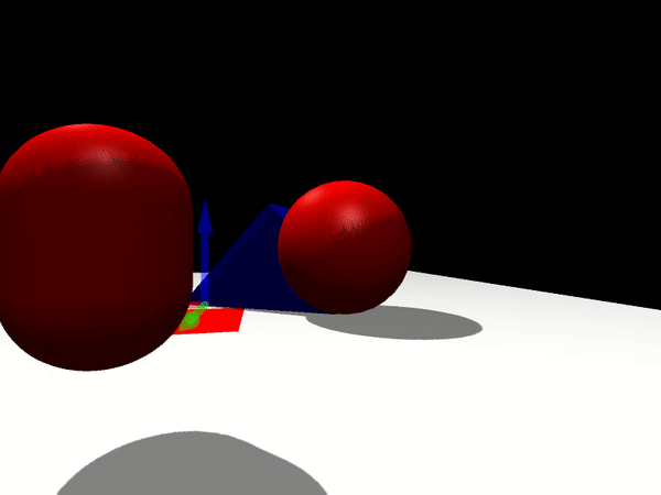

Simple demo
This example shows how move the camera automatically.
Clone the source code, create a build directory and use cmake
and make
to compile the code:
cd ign-rendering/examples/simple_demo
./simple_demo
[Msg] Loading plugin [ignition-rendering7-ogre]
Engine 'optix' is not supported
The function updateCameras()
is called each time the DisplayCB
function runs. Using the method SetLocalPosition
from the Camera
class we can move the camera in the world:
void updateCameras()
double angle = g_offset / 2 * M_PI;
double x = sin(angle) * 3.0 + 3.0;
double y = cos(angle) * 3.0;
for (ir::CameraPtr camera : g_cameras)
camera->SetLocalPosition(x, y, 0.0);
g_offset += 0.0005;
