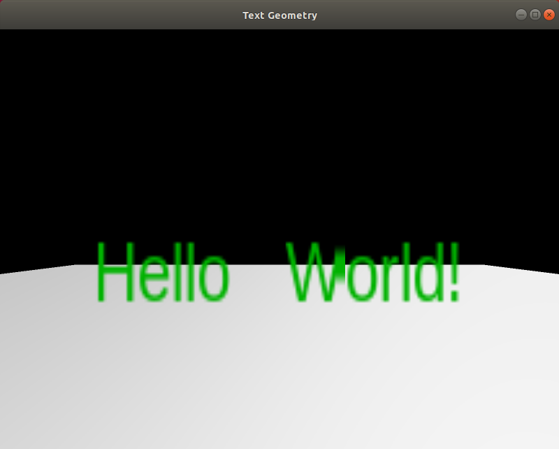

Text geometry
This example shows how to include text in the scene.
Clone the source code, create a build directory and use cmake
and make
to compile the code:
cd ign-rendering/examples/text_geom
./text_geom
[Msg] Loading plugin [ignition-rendering7-ogre]
Engine 'optix' is not supported
We can create text in the same way we create other objects in the scene. We just need to use the scene to create the text using the method CreateText
. It's possible to configure: font, text and alignment. Then we need to add the text as a visual in the scene:
TextPtr textGeom = _scene->CreateText();
textGeom->SetFontName("Liberation Sans");
textGeom->SetTextString("Hello World!");
textGeom->SetShowOnTop(true);
textGeom->SetTextAlignment(TextHorizontalAlign::LEFT,
TextVerticalAlign::BOTTOM);
// create text visual
VisualPtr text = _scene->CreateVisual();
text->AddGeometry(textGeom);
text->SetLocalPosition(3, 2, 0);
text->SetLocalRotation(0, 0, 0);
// Only diffuse component will be used!
text->SetMaterial(green);
root->AddChild(text);
