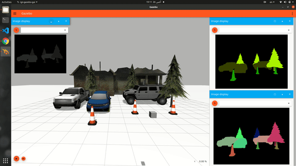

Running an example:
Now that we've discussed how a segmentation camera and models with labels can be specified, let's run an example world that uses the segmentation camera. Run the following command:
ign gazebo segmentation_camera.sdf

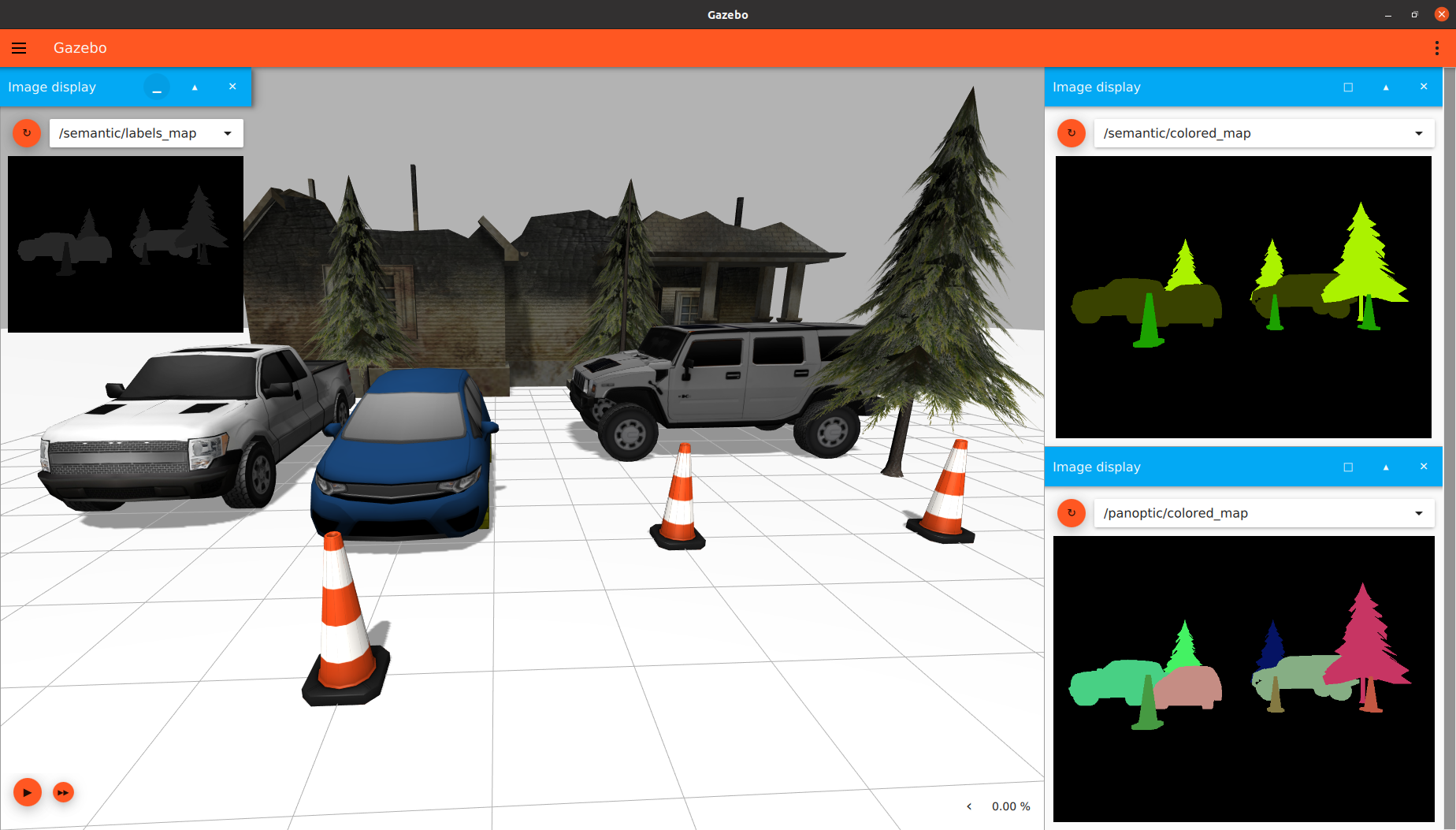

You should see something similar to this:
There are 2 segmentation cameras in the SDF world: a semantic segmentation camera, and an instance/panoptic segmentation camera.
For the instance/panoptic segmentation camera, colored map data is published to the panoptic/colored_map topic, and label map data is published to the panoptic/labels_map topic:
<sensor name="instance_segmentation_camera" type="segmentation">
<topic>panoptic</topic>
<segmentation_type>instance</segmentation_type>
<horizontal_fov>1.57</horizontal_fov>
<width>800</width>
<height>600</height>
<far>100</far>
<save enabled="true">
<path>segmentation_data/instance_camera</path>
</save>
For the semantic segmentation camera, colored map data is published to the semantic/colored_map topic, and label map data is published to the semantic/labels_map topic:

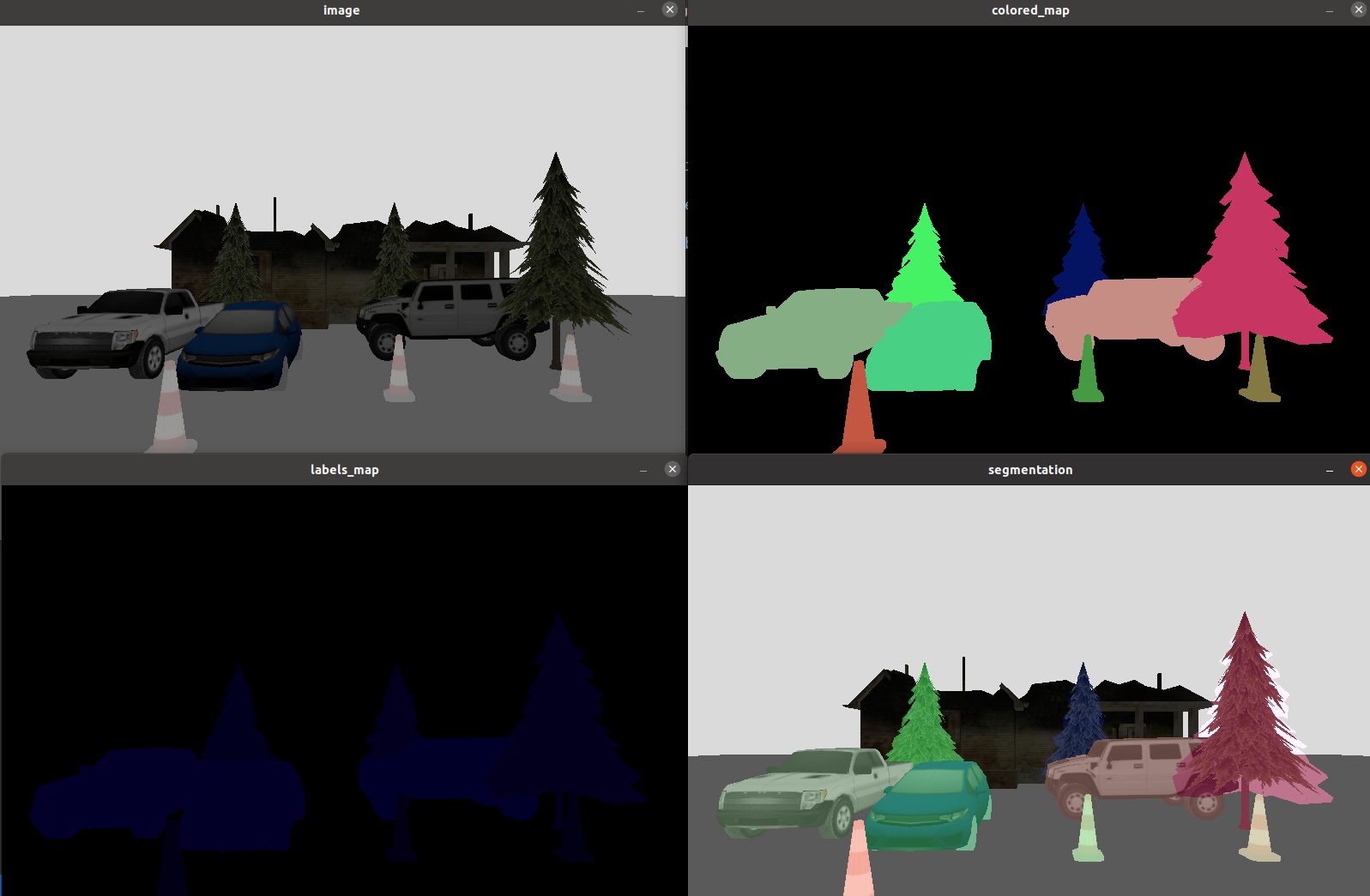

Make sure you have all of the dependencies that are needed in order to run this Python script:
Run the script, setting the --path argument to what you specified for the <save> tag in the SDF file. Since we set the panoptic save path to segmentation_data/instance_camera, we'd run the following command to view the panoptic segmentation data:
python3 segmentation_visualizer.py --path segmentation_data/instance_camera
You will see 4 windows: image, labels_map, colored_map, and colored_image (which is a combination of the image and colored_map).
For panoptic/instance segmentation, to parse the labels_map, click on any pixel on the labels_map window to see the label and instance count of that pixel.
