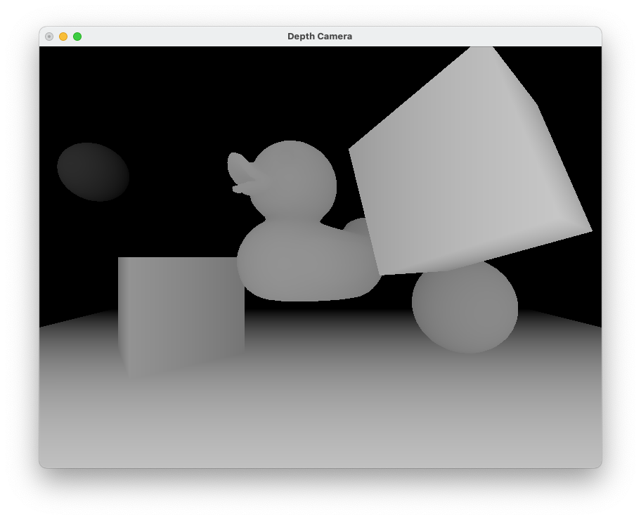

Depth camera
This example shows how to use the depth camera.
cd ign-rendering/examples/simple_demo
./depth_camera ogre

The window updating code is in GlutWindow.cc. The function initCamera() registers a callback with the camera that captures a copy of the depth image each frame. This will later be drawn to the window in the main update loop.

The depth camera is capable of generating both color and depth data. This example shows how to connect and receive depth data in the OnNewDepthFrame() callback function.
void OnNewDepthFrame(const float *_scan,
unsigned int _width, unsigned int _height,
unsigned int /*_channels*/,
const std::string &/*_format*/)
unsigned char *data = g_image->Data<unsigned char>();
ConvertDepthToImage(_scan, data, _width, _height);
It converts the depth image to a RGB grayscale format and copies it from the depth camera to a memory reserved in a globally scoped Image.
